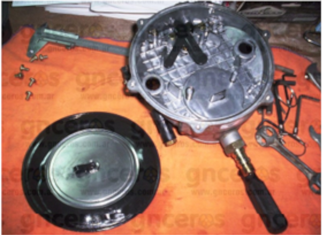

What pressure should a Single point vapouriser/reducer be set to?
I would guess there's a max-min pressure tolerance exiting vaporisers/reducers. I would think multi-point systems require higher pressures. I'm rebuilding a OMVL 89e, which is much like its LPG cousin, OMVL 90e. There's no info anywhere on setting the low-pressure lever height. Better I use a manometer anyway. For fear of turning this into the next Tooless thread:
1) What's the pressure?
2) Which way do i tweak the bar to increase/decrease? I'm assuming bending the bar towards the membrane increases pressure?
3) Does a BLOS need more pressure than say, a cooker-ring or stepper-motor closed-loop system?

Re: What pressure should a Single point vapouriser/reducer be set to?
Pressure would be fractionally below atmospheric so the gas has to be sucked through by the venturi in the mixer (I assume a Blos does the same, never played with one and consider they just add complication over a ring mixer) rather than blown in. On the 90e you don't bend anything, the pressure is adjusted with the larger of the two screws (the one with the spring behind it) which sets the pressure by acting on the lever. The smaller screw (the tapered one), is an idle bleed to allow a constant flow irrespective of the amount of suck from the mixer and dribbles a small amount of gas through to keep the engine running at idle if there is insufficient suck.
The reason I point my finger at the OMVL is that lifting the BLOS piston does not stall the engine until it's near WOT. ie the gas-supply does nto increase.
Not the way I read it, it's at atmospheric 0±20 Pa, see https://www.lpgteile.de/intern/809100_0 ... Manual.pdf
Can't help with bending of arms etc inside the R89 reducer... the best people to answer that are probably TinleyTech but I'm not sure how much help they'll be able to give. On an R90 you can probably effect the same things as bending the arms using the adjustment screws.
R90s (and other mixer system reducers) supply gas at very close to atmospheric pressure.. if they supplied much positive pressure it would cause the engine to run way too rich at idle, negative pressure would cause the engine to run way too lean mostly effecting idle (presuming correctly sized mixer).
