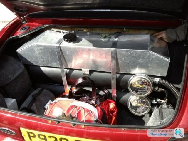

Very interesting, coming up to proof-of-pudding stage !
It's a shame the reducer couldn't be more tucked away, but every install has some compromise.
The tankage is neat solution given the confines, I doubt a 300 mile range but you does what you can here. Someone mentioned the potential for slosh issues on cornering, but I reckon that won't trouble you in a non-racing environment. Better that than slosh on accel
I have to say with my UKLPG inspector hat on, defeating the 80% tank fillstops would get it bounced clean out the door. It's unlikely to be detected in practice of course, but I do think you may also exacerbate the effect of any cross-feed dribbles that occur in multitank installs and suffer unexpected venting.
PS - you can ignore the nay-sayers about "it'll cost more than petrol next year", they've been saying that since 1990 to my knowledge.

A big thank you to Keith Woods at Quest Motorsport who made an excellent job of turning my dual fuel TVR Chimaera idea into reality.
http://www.pistonheads.com/gassing/topi ... n%29&mid=0

I'm still not conviced about no gas temp and pressure correction with the ECU setup you have chosen but it looks like it is working well enough.
Looking through your pistonheads thead I'm curious as to when you are going to complete the tank installation. It would be a good idea to put the vent pipes on asap just in case they are needed, more critical after your mods to the valves. You also need to sort the fill pipe so that it exits through the floor to stop water getting in or gas as you fill.

Wrong, it works actually brilliantly.classicswede wrote:I'm still not conviced about no gas temp and pressure correction with the ECU setup you have chosen but it looks like it is working well enough.
But you do seem to have answered your own question so I'm not really sure what you're trying to say here?
I did have another option with all this, I could have put a piggy back on the 14CUX and cobbled a Megajolt onto it in place of the distributor.
With this type of hash up the piggy back may well have referenced gas temperature, but would it have been better?
I think not?
Only Mark Adams can properly map a 14CUX, so if it's out on petrol, it's going to be out on gas, until I pay Mr Adams way too much money to tweak it.
Things have moved on & there are better systems out there that puts the mapping back in my hands.
Remember this is a 260hp TVR, not an old warn out Disco getting converted at the end of it's life.
It's a 1000kg thrilling high performance sports car, it deserves better than what the average LPG fitter would put on an old Range Rover Classic.
With a system that moves on from twisting second hand petrol injector durations that are completely wrong for LPG in the first place, the Canems Duel Fuel engine management system allows us to create the perfect fuel and spark tables from the outset.
This does however require the skills of an experienced engine mapper and a rolling road, the type of skills most LPG fitters lack because their compromised piggy back ECU systems do most if not all the petrol signal twisting for them.
Performance engine mapping is an art, trust me.
You clearly failed to read the whole post, there lots of pictures of the completed installation towards the end, including the bespoke 8 gallon petrol tank fabricated by Keith Woods, and the twin 30 litre LPG tanks.classicswede wrote:Looking through your pistonheads thread I'm curious as to when you are going to complete the tank installation.
The only thing that remains is for the tank system to be professionally trimmed in matching boot carpet making it virtually indistinguishable from a standard petrol Chimaeera even with the boot lid raised.
???? Vent pipes are in place, what makes you think they aren't?classicswede wrote:It would be a good idea to put the vent pipes on asap just in case they are needed, more critical after your mods to the valves.
Do you really think we would do all this & not sort the venting?
More????? What on earth are you talking about?classicswede wrote:You also need to sort the fill pipe so that it exits through the floor to stop water getting in or gas as you fill.
Why would I cut a hole in my floor, you may do this on an old Jag, but not on my car thanks!
The LPG filler is where the petrol filler was, it's a beautifully neat integrated solution that requires no hole cutting or other crude invasive treatments to my TVR.
In all my years around TVRs I have never seen or even heard of a TVR taking on water through the petrol filler cap, it' resides under the boot lid for heavens sake!!!
All in all Mr "classicswede" (& I don't mean to be rude) I recommend you re-read the post on PistonHeads properly my friend.
It's all there!

Or you could have fitted a later GEMS or Thor engine with matching control system. Let's face it, the 14CUX hasn't been used by LR since 1994 and it never was very good in the first place ( I own and use a 14CUX and a GEMS and I know which one is the better of the two and it certainly isn't the 14CUX). That way you could have mapped it on petrol and used a standard piggy back LPG ECU to do the job. V8 Developments do tuned 4.6 litre and a 5.3 and 5.5 litre version of the engine which are good for over 400 bhp. You'd also have OBD compliance too so would be able to use one of the LPG systems that connects to the k line and self corrects any anomalies in the mapping.ChimponGas wrote:I did have another option with all this, I could have put a piggy back on the 14CUX and cobbled a Megajolt onto it in place of the distributor.
We don't know. The final picture on the Pistonheads thread shows that you appear to have only used 1 vent tube from each gastight lid. I would suspect that with the fill and feed pipes running through it the remaining cross sectional area is below the 450 sq mm that CoP11 stipulates. Even a single copper feed pipe through a 26 mm vent tube reduces it below this. That's why there is the option for two from each gastight box. Where's the gas going to go when the pressure release valve opens if you did mess with the fill stops?ChimponGas wrote:Do you really think we would do all this & not sort the venting?
Yes....... I would be interested to hear Keith's view on this as he is the one who is likely to be certifying it. CoP 11 clearly states:ChimponGas wrote:The LPG filler is where the petrol filler was, it's a beautifully neat integrated solution that requires no hole cutting or other crude invasive treatments to my TVR. In all my years around TVRs I have never seen or even heard of a TVR taking on water through the petrol filler cap, it' resides under the boot lid for heavens sake!!!
It should not be necessary to keep any passenger door, bonnet or load compartment door open during the filling process.
No gas should enter the vehicle during filling or on connection or disconnection of the filling gun. A gas tight sealing "boot" should be fitted to the part of the filler assembly inside the vehicle unless other effective means of ensuring a seal during service are provided.
To my way of thinking, the fact that you have to open the boot to fill means that the install is non-compliant. It also means that when you remove the filler gun, that pssst you hear is LPG that is dropping into the lower recesses of your boot to pool in there. With no hole in the bottom to allow it to escape, it's just laying waiting for an opportunity to ignite. You may not like the idea, but you do need a hole in the boot floor.
Don't get me wrong, I'm not knocking your efforts but I do feel you have been re-inventing the wheel a lot of the time. You've decided that the 14CUX is carp, a fact that I doubt anyone would disagree with, so you have no desire to piggy back an LPG ECU onto it. But rather than updating to a later, manufacturer developed, system that can be mapped (or just buy the Tornado chip to go in it) and piggy backing off that, you've spent an awful lot of time, effort and, presumably, money virtually starting from scratch with an unknown system. You admitted there was a problem with the impedance of the injectors but the Canems manufacturer was able to sort it. What would you have done if it couldn't be sorted?

The photo near the end of your thread is how I know that you have not yet done the tank venting.
You are only using half of teh available venting space.
The filler is a trap for heavy LPG. Fantastic idea that.
You have an exposed joint in the form of a T in the boot area
To me you have a nasty habit of jumping to conclusions. You come over as a sales rep premoting the camens system.
The early injection systems (Dream xxi etc) did not have a gas pressure sensor or gas temp sensor and worked ok. The updated N systems with the pressure and temp sensors were a great leap forward. A mappable petrol ecu with switchable map would have done the job better combined with a specialised LPG ECU rather than a experimantal system. The camens system is obviously still very experimental at this stage and as you have already found there are still some bugs in it.
Fortnaly for you your engine is not eaxctley demanding and still fairly unstressed. On a more highly tuned engine the years of development put into the piggy back LPG systems would pay off over some experimental electronics.
I'm glad it is all working ok for and I was sure it would be acceptible to you with the way it would work. The trouble is there is a lot of comprimise over what could have been done. I'm sure with further development and testing with the additional imputs the cames system could be very good
