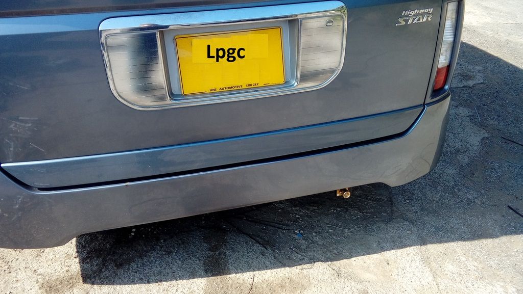

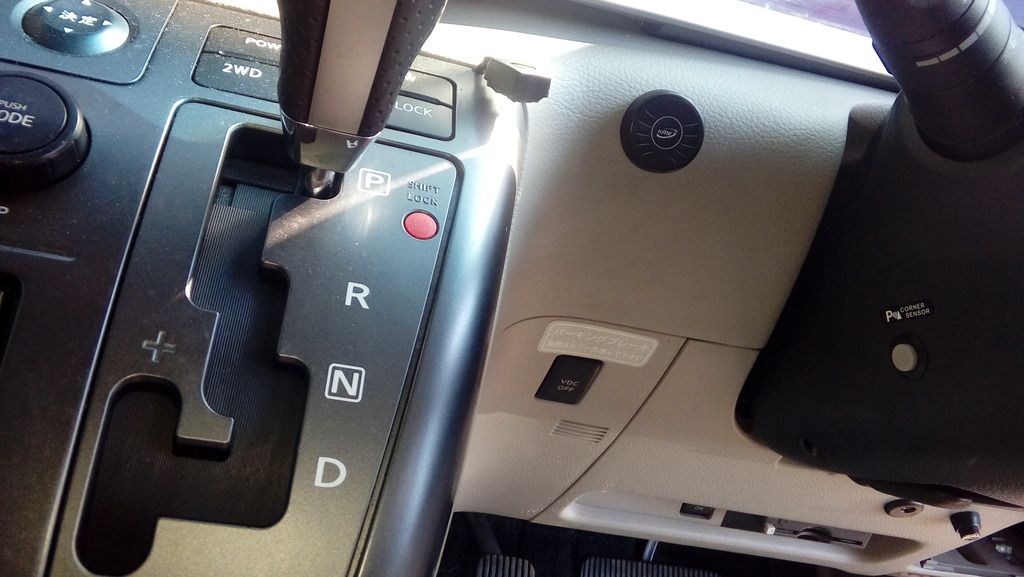

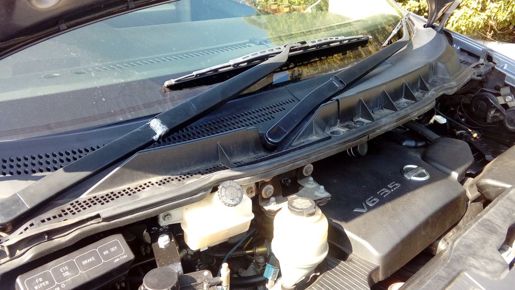

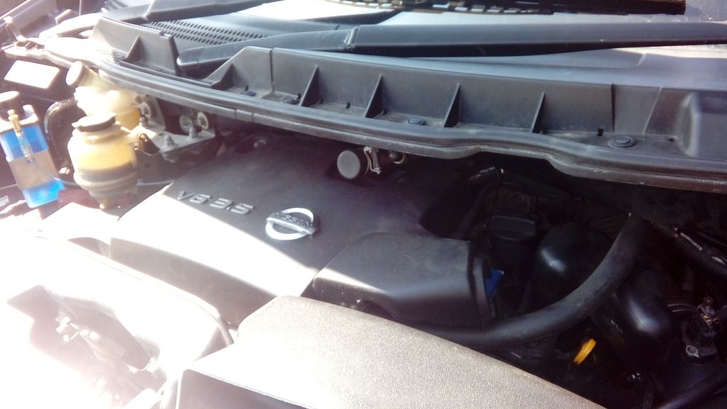

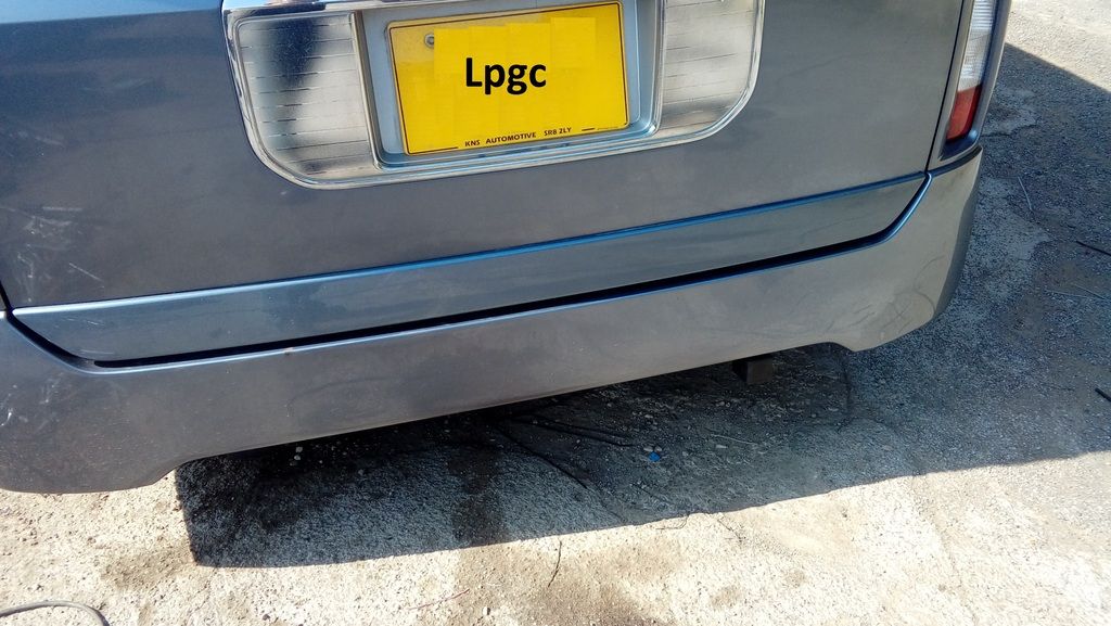

Converted a lot of these recently, here's the latest, the second one I did this month.

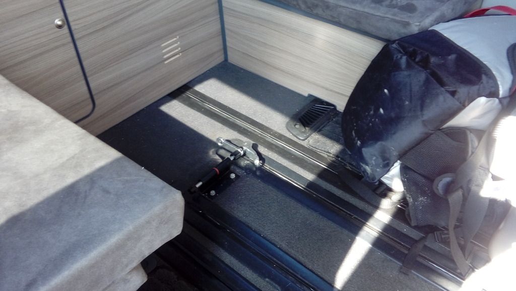

Owner had me decore the rear catalytic convertors and fit an internal bike securing bracket while I was converting this one.
Square filler at the back
engine bay
switch
bike bracket
